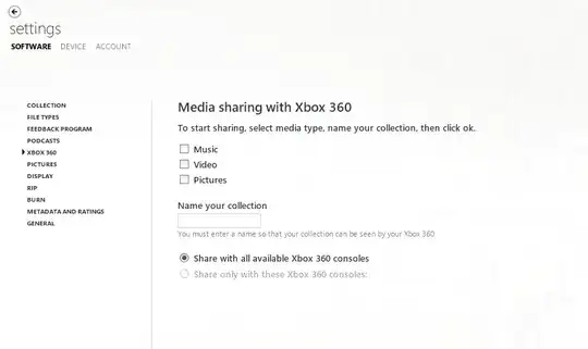

Did you know the Zune Software supports streaming music/video/pictures to Xbox 360's? alt text
have personally never tried this, since I don't own an Xbox...Knowing Zune and Microsoft though, I'm sure this would work pretty well with tight integration...
