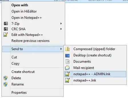

just a simple and effective method:
  1. create a shortcut on the desktop (c:\program files\notepad++\notpad++.exe -> right click -> sendto -> desktop)
  2. create a copy of that shortcut and add _ADMIN to the shortcut
  3. right click the _ADMIN shortcut - properties - shortcut - button advanced - tick "run as administrator"
  4. open a file explorer and type "shell:sendto"
  5. drag and drop both shortcuts to the opened folder
now you have both notepad++ and notepad++_ADMIN in your "SendTo" list for any file.
Shell contextmenu
Bernhard
  • 191
