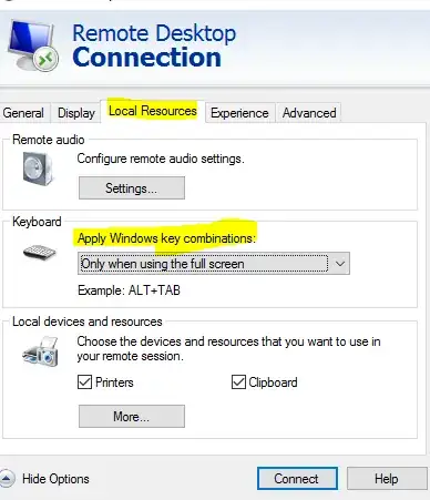

It is the way the RDP client responds to control keys.
To resolve, try going into the options for the Remote Desktop Connection>Local Resources>Keyboard and change to "On This Computer". RDP Local Resources
Be aware that alt+Tab and similar commands will now run on the local system.

    Tried that, but it did not help. (It did mean that the alt-tab did not work on the remote computer, so the setting was in effect) – sgmoore Dec 17 '10 at 17:53
    I second @sgmoore's report: Restricting key combinations to the local computer does not avoid this problem. – einpoklum Nov 15 '13 at 19:10
    The RDP Keyboard "On This Computer" setting was the only thing that successfully resolved the annoying issue for me. To replace the alt-Tab on the target machine, I'm using switcheroo.io, which is an open-source project on GitHub. I find it even better than the original Win7 alt-Tab dialog. – V-R Dec 30 '15 at 11:42

I've found the solution to this where one is using nested instances of Microsoft's Remote Desktop client. Imagine the following situation. You're sitting in front of an OS X machine, and you remote desktop into a Windows 7 laptop. From the Windows laptop you want to remote desktop into another Windows machine (in my case a work box over VPN). The solution to your keyboard mapping woes is: on the Windows laptop, i.e. the destination of the first jump, change the remote desktop hardware settings for the 2nd jump to use the local keyboard, not the connecting one.
Edit
To change the setting:
  1. Open de Remote Desktop Client.
  2. Do not connect to a remote host, yet.
  3. Click button Options.
  4. Open tab Local Resources.
  5. Choose option "On this computer" in drop-down list de Apply Windows key combinations.
Although this setting does not seem to apply to simple Shift-key combinations, it did solve the problem for me, when working with nested remote desktops.
Of course, it comes at a price: you cannot Alt-Tab through the windows on the remote host, etc.
