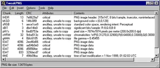

Another option is TweakPNG, on Windows.
I can see that is having problems displaying the Hans Müller name in your image, so maybe it does not work with Unicode metadata.
TweakPNG
