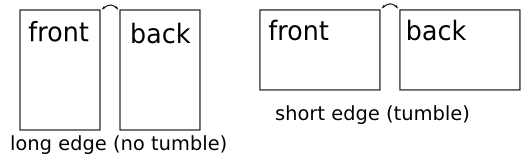

When you print duplex (i.e. double-sided), you have several options as to which direction the reverse should be respective to the converse. Long edge duplex means that you turn the paper along its long edge, so that the up direction is the same on both sides of the paper in portrait orientation. Short edge duplex means that you turn the paper along its short edge, so that the up direction is the same on both sides of the paper in landscape orientation.
see ascii art below
 │front│ │back │    │front   │ │back    │
 │     │ │     │     short edge (tumble)
long edge (no tumble)
