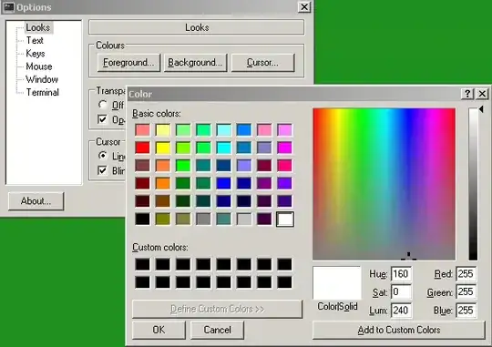

It turns out that mintty has a menu, and one of the choices is Options
a color picker
Thomas L Holaday
  • 822
    This only allows edits of 3 colors, not the full ANSI pallette. Currently you need to use the xterm control sequences to edit the other colors, as ak2s link suggests. – thetoolman Apr 11 '12 at 21:17
