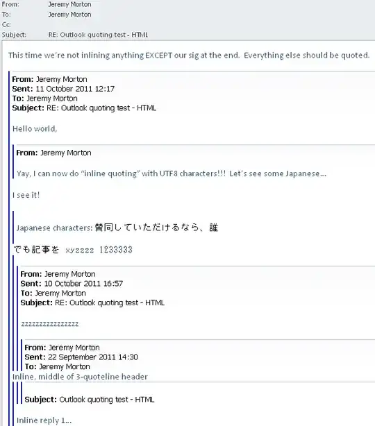

Here's a screenshot to show what inline responses look like in Outlook 2010 once the fix is applied (yeah, it's messy because I was comprehensively testing it; all the stuff here is exactly what the (top of the) e-mail looked like before I hit 'Send'):

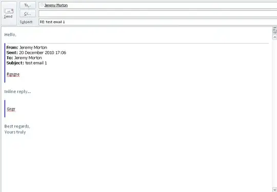

When you reply to an HTML e-mail message in Outlook, the quoted text has a blue line down the side, and is usually at the bottom of the message:
alt text
Now in Outlook 2003, when replying to HTML-formatted messages in Outlook, you used to be able to reply inline quite easily, by getting to the point in the quoted message you wanted to reply to, and pressing the 'decrease indent' button:
alt text

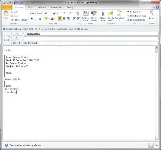

Since Outlook 2007 (and 2010), they replaced the e-mail editor with Microsoft Word. This means the blue line is implemented in a different way; it uses a blue left border. This makes it tougher to break the line up. After much ado, I found a couple of pages that said that you could remove all formatting by pressing Ctrl+Q, which would remove the blue line next to the cursor and allow inline replies:
alt text

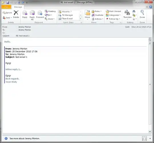

OK, not too bad on the face of it. I can live with that. But here's the kick in the teeth; try sending that mail. I'll send it to myself. What do I receive? This:
alt text
Outlook 2010 reinstated the blue line, where I had removed it, upon my sending the e-mail! For God's sake! The two pages I linked to above don't seem to address Outlook's reinstating of the blue line upon sending.
So, does anyone know how you can actually reply inline in Outlook 2010 (or Outlook 2007) e-mail without the blue line being reinstated? Before anyone says, I do not want to convert the message to plaintext, and I do not want to just indent replies and have to manually build the blue line myself. I want something like the Outlook 2003 behaviour; I reply, Outlook creates the blue line, and I can break it up with inline replies, send it, and my inline formatting stays.
