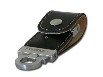

I have one of those fancy schmancy devices, which is given to me by a frustrated friend of mine.
Device is a Prestigio Leather 8GB
It identifies itself to Linux host as:
Bus 001 Device 006: ID 1307:0165 Transcend Information, Inc. 2GB/4GB Flash Drive

So, symptoms are typical for U3-like devices: two separate devices inside of a single flash device. Windows sees it also as two identical usb devices, and mounts two separate drives to system, whereas first one presents itself as a CDROM device, holding a write-protected content, and second is a regular flash-disk partition, that "can" be written to. However, it seems like it's broken in some weird way, since it won't let me write anything to it, format it, nothing, but that's not the issue right now.
Question: How can I unlock entire USB stick so it appears to system as a single, 8GB device which can be partitioned and used normally, without restrictions?
