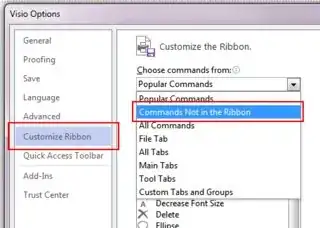

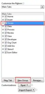

Visio 2013 and later use Themes to define the default connector. Here's how to change the Theme that affects the default connector (the one used when choosing the Connector tool on the ribbon or by pressing CTRL+3). This affects the current document only:
  1. Add the Define Styles command to the ribbon (it's not there by default):
    a. In the File menu choose Options then select Customize Ribbon in the left pane.
    b. You need a custom group in which to add the command, so below Customize the Ribbon select the entry for the Design tab then click New Group.
    b. In the Choose commands from: dropdown select Commands Not in the Ribbon. enter image description here
    d. Find the command Define Styles.... Select the custom group you added in step b, then click Add > >.
    e. click OK to close Visio Options.

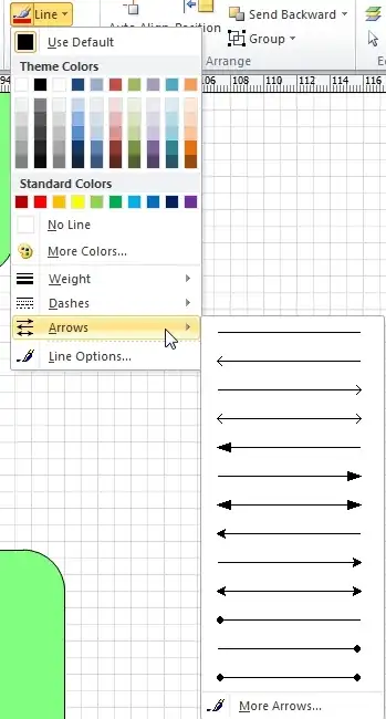

Select the connector. Find the Line menu:
Go to the Arrows sub menu and select style. Weight, Dashes and Line Options will also help... Line options makes curved cornes...
spinodal
  • 1,501
  • Thanks, but thats not exactly what i wanted. I'd like the default connector that gets drawn will already be with some specific properties without me having to set them for every new connector i make. – yurib Jan 06 '11 at 10:42
  • This changes an *existing* connector, but does nothing to modify the **default** connector, which is what the question is asking. – I say Reinstate Monica May 24 '18 at 00:05
