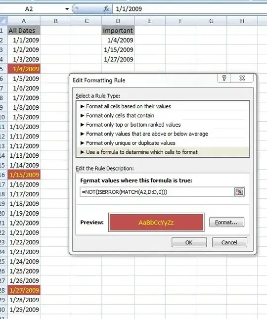

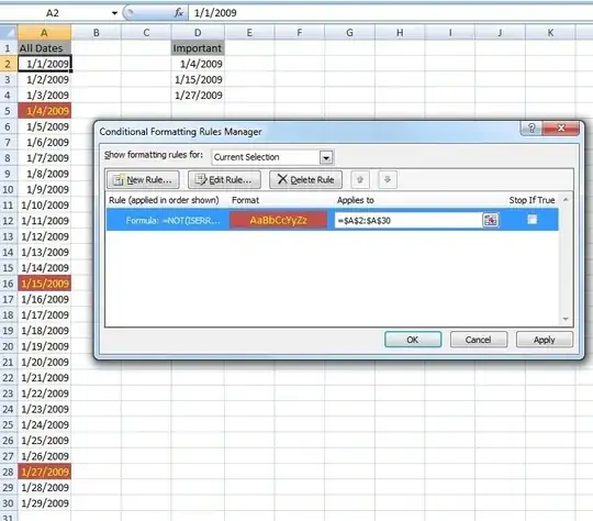

Sorry for the images as an answer, but it's faster for me:
