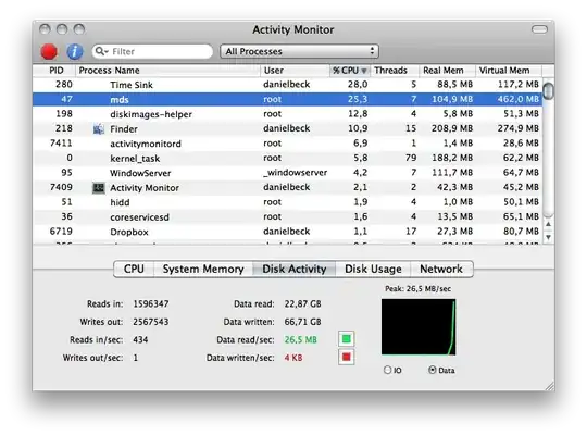

It'll probably show up in /Applications/Utilities/Activity Monitor.app. Select All Processes in the toolbar to see processes of all users.
The screenshot is from when I was searching something. I guess you'd kill mds by pressing Cmd-Opt-Q after selecting it to terminate Spotlight, but I'm not sure -- probably best if you checked CPU usage and/or if the name of a process is written in red, indicating it froze.

  • odd.. as soon as I force-quite it, it appears back there and my spotlight menu is still up working away at nothing. – Damon Jan 10 '11 at 22:22
    @Damon It's a server intended to run all the time, and gets restarted once you stop it. If it were responsible for the issue, killing it would fix it. Have you tried looking for another task, that maybe uses much CPU, or maybe tried to simply restart Finder? – Daniel Beck Jan 10 '11 at 22:24
  • restarting finder was the first thing i did.. nothing else really doing much other than Window Server.. looks like i'm just going to have to reboot – Damon Jan 10 '11 at 22:54
