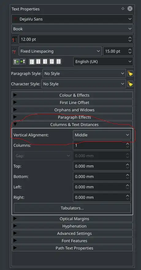

Using Scribus 1.5.4:
  1. Right-click on a text box and select Text Properties;
  2. Click on Column & Text Distances;
  3. On the first line, change Vertical Alignment to the desired value (for example Middle).
Screenshot of the Text Properties menu
No need for scripts, manual margins or black magic.
