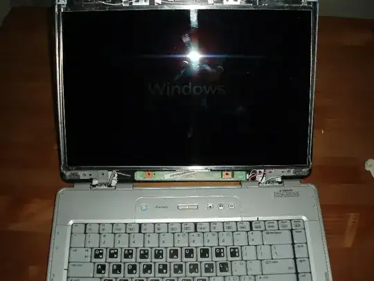

Here's an example of what it looks like when the backlight burns out. As you can see, it's incredibly hard to see the picture at all. If you think you have eye strain from looking at a light source, it pales in comparison to trying to read one of these: burnt out LCD backlight
If you are really adverse to looking at a bright light, try turning down the brightness. It's not the same as an eInk display, but I don't believe those are available as general purpose displays yet, and have an refresh time measuring most of a second (not 5 thousands of a second like a "typical" LCD).

  • Thanks for the response mate! I was wondering why common LCD's do not reflect light (but you cleared that up). I can turn off my laptop's backlight and it looks the same as in your photo. I was thinking, maybe allow the light to go towards the screen (like a lamp lighting a book) instead of the opposite way. But that's probably not an option. Anyway, thanks for listing the categories. – Spectraljump Jan 17 '11 at 07:41
