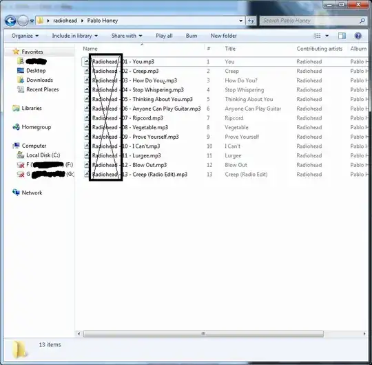

Basically, I have an album of music and I want to remove the authors name from all of the mp3 files instead of having to manually do it myself. Is there a function in Windows 7 Ultimate that can do this for me?

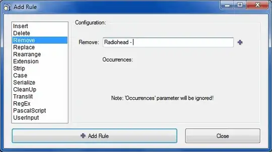

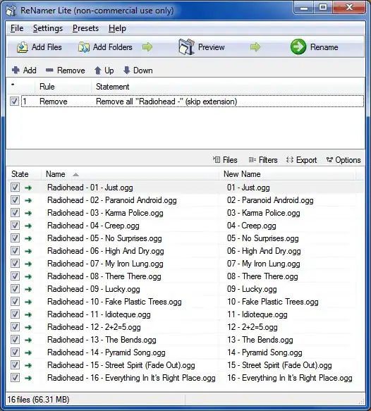

ReNamer can do that. In ReNamer, just add a 'remove' rule like this (a 'delete' rule will also work):
ReNamer 'remove' rule
And then drag and drop the files, or the folder containing the files you want renamed to its window (or use the 'Add Files/Folders' buttons), then check the preview, and once verified, click on 'Rename':
ReNamer window

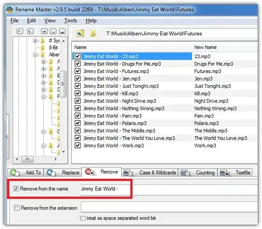

I just want to add my favorite: Rename Master
This utility will add, remove, or replace parts of the filename with ease and also supports renaming via file properties, MP3 tags, JPEG JFIF and EXIF tags, Video tags, and text files. Batch renaming that's simple to use, yet still very powerful.
Features
  • Portable mode
  • Intelligent number sorting
  • Full Unicode filename support
  • File and folder renaming
  • Custom filelist columns
  • Auto-Preview
  • Subfolder Scanning to rename files in multiple folder
  • Renaming Variables for JPEG/MP3/Video tags, file properties, counters, and more
  • Scripts to save commonly used renaming options
  • [*] and [?] command prompt style wildcards, or full Regular Expression support
  • Optional Explorer integration for right-clicking on files/folders or using "Send To"
  • Case Changing and Textfile importing
  • Command line options for batch renaming
