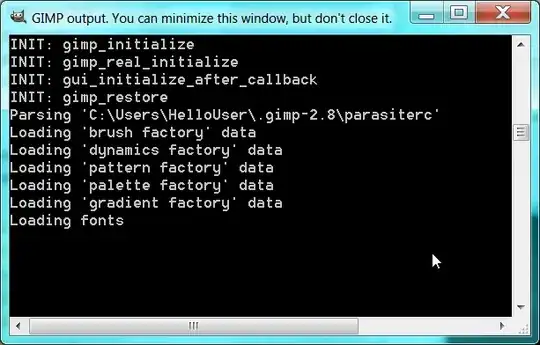

Selected answer worked for me.
However, had to use different steps.
Using Windows 7
Using Gimp 2.8
=== Step 1.   Diagnose ===
  1. Navigate to C:\Program Files\GIMP 2\bin
  2. Shift + Right Click -> "Open Command Window Here"
    (click the empty space of the folder, not an icon)
  3. Type gimp-2.8.exe --verbose
  4. Watch the Gimp console that pops up :
    see what is taking the longest to load.
Gimp console pic -- hanging on "Loading fonts"
For me, it would hang on "Loading fonts" for 15 seconds,
every single time I launched.
  1. For a quick process of elimination :
    close Gimp + type this into Windows Command Prompt
    gimp-2.8.exe --verbose --no-fonts
n o t e :
calling gimp-2.8.exe only works if your console's path
is the same as the gimp-2.8.exe directory.
=== Step 2.   Locate Gimp's font cache ===
C:\Users\User_Name\ had no files resembling ".fonts-cache1"
C:\Users\User_name\.gimp-2.8 had nothing font related except an empty fonts folder
If you do find it there : follow the steps of the selected answer above.
On my machine :
the font folder where Gimp 2.8 stores its font cache
is located in : C:\Users\User_Name\AppData\Local\fontconfig
    h i n t :
    click Windows start button, type %appdata%/../local then press enter
=== Step 3.   Verify this is the right folder ===
Inside of C:\Users\User_Name\AppData\Local\fontconfig
there should be a folder called cache.
Rename it to anything else : example cache.backup .
  1. Stay in the ..\AppData\Local\fontconfig directory.
  2. Run Gimp.
  3. See if it generates a new cache folder.
If so, you definitely know that this is Gimp's font cache folder.
=== Step 4.   Hopefully it's fixed; let's find out ===
The last step hid Gimp's cache,
and Gimp regenerated a new one.
If you close Gimp + reopen it,
it should open significantly faster
(hopefully this was the root of your problem!)
