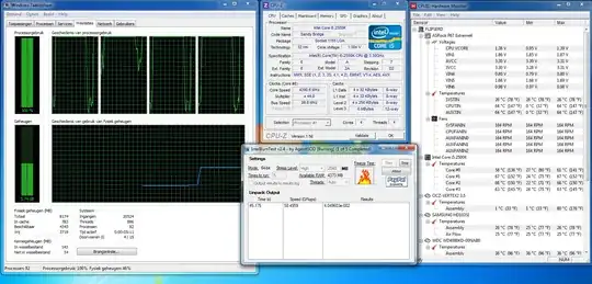

To add some proof of my own:
Enter image description here
Note that I'm using water cooling, so my idle temperatures are normally around 30 degrees Celcius. Clearly yours are a bit high, but certainly not too high.
