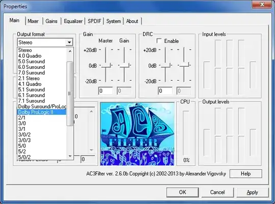

AC3Filter (a decoder and processor filter) can allow downmixing to Dolby Surround/Pro Logic or Dolby Pro Logic II, if configured to do so. Your media player must also be configured to use AC3Filter.
Relevant features as quoted from its website:
  • Down-mix any audio track to any number of channels (to match your speaker configuration)
  • If you have an external Dolby ProLogic decoder, you may use ProLogic down-mix to help DPL decoder to extract surround information
Screenshot of AC3Filter configured to output in Dolby Prologic II
