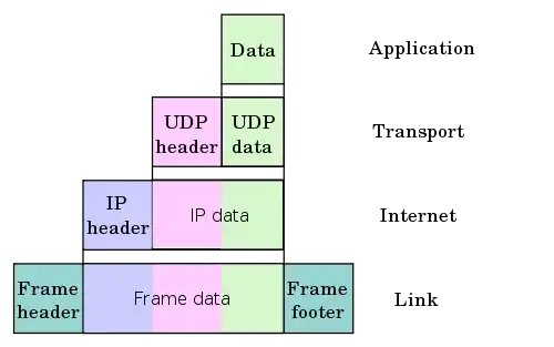

Packet is an ambiguous term here because it is sometimes misused to refer to different elements for your transmission. Lets see what your data is wrapped up in and you'll see what I mean, and hopefully get the answer you wanted:
Lets assume you're sending 1 byte of data1 over the internet, on the TCP/IP model.
The data starts on the application level and needs to be wrapped up in headers for the lower levels so that it can be passed around.
First that data is wrapped in a TCP Segment, which adds a header of 20 bytes (min size now 21 bytes).
This puts us on the transport level.
This is then wrapped in an IP Packet, which adds another header of 20 bytes (min size now 41 bytes).
Now we're on internet level.
Note that this wrapping is changed each time a new router forwards your data to a new subnet.
This is wrapped in a link frame of some type - of which the header and footer size vary depending on the type of frame used, which depends on the type of link being used.
This is on link level.
This wrapping is changed each time the unit if transmitted between two entities.
Finally is the physical transmission (eg, electrical signals down a cable, radio waves, etc).
Here's some informative images available from the Wikipedia TCP/IP model page that hep to visually explain what is happening:
Data encapsulation using UDP/IP
Connection via layers in the TCP/IP model
