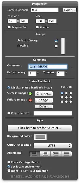

Here is a screenshot, how my Shell geeklet is configured; besides name, position, and "default group" yours should look quite similar:
shell geeklet to display time
