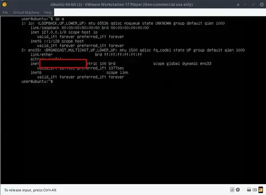

I'm using VMware Workstation 17 Player. The host operating system is endeavouros. The guest operating system is Ubuntu 22.04.2 server.
  1. Click on the network icon in the bottom right corner and choose NAT. See the first screenshot below.
  2. Do the following on the guest machine. Type ip a in the terminal and press Enter. The output of the command is shown in the second screenshot below. Copy the ip address in the red rectangle.
  3. Do the following on the host machine. Type ssh user@ip Replace user with your username and ip with the ip address you copied in the previous step. SSH asks for your password. You should be logged in on the guest machine after entering your password.
Choosing network adapter configuration ip a output
