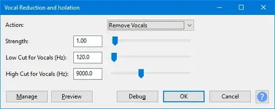

Audacity
Audacity – a free and open-source cross-platform audio editor – can do this, using the Vocal Reduction and Isolation effect. You should first extract the audio from the video file, e.g. using ffmpeg:
ffmpeg -i video.mp4 -c:a pcm_s16le audio.wav
And then load the audio.wav file into Audacity:
If you only want to get background music, select the Remove Vocals option; if you want the opposite, choose Isolate Vocals.
Note that this is never going to sound perfect. Vocal isolation is a hard task, as everything you hear is basically mixed into two tracks. An algorithm will never be as good as your brain in isolating different sound sources. Your audio source should be a stereo file with the vocals being panned dead-center. It might also produce false-positives, removing other instruments in the process.

    This was one of best tutorials I've read about Audacity. Underrated answer. Thank you very much :) – Zeta.Investigator Dec 02 '17 at 18:59
  • Is it just a band-pass filter? Then what is "Strength" meaning in this? Does is attenuate the amplitude of the out-of-band signals or does it have something to do with power (or log of power)? – Zeta.Investigator Dec 02 '17 at 19:01
    @Zeta.Investigator Just briefly skimming the article and the [source code](https://github.com/audacity/audacity/blob/bba5a8fef1e6c321290b4c7d1ca59fc67863d6cf/plug-ins/vocalrediso.ny#L165), it appears to be the power of the band pass / band stop that will be added or subtracted from the center. Apparently it's normalized by the difference between 1) the power of the middle vs. overall signal and 2) the power of the side vs. overall signal. Then it's exponentiated – so I assume it's on the log scale. (But I'm not an expert on this kind of processing or LISP.) – slhck Dec 03 '17 at 11:30
