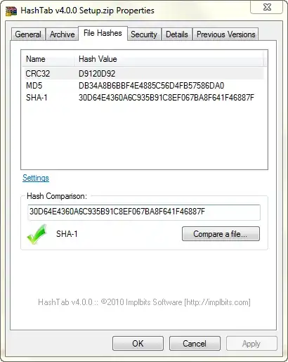

You may, however, wish to use this freeware app called HashTab that integrates neatly with Windows Explorer by registering a... well, a tab in the properties dialog of files. It's pretty sweet.

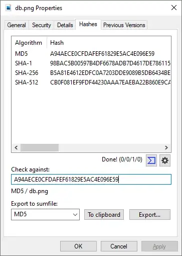

99I prefer [HashCheck](http://code.kliu.org/hashcheck/) over HashTab, primarily because it can handle multiple mixed file/folder selections and it can create/verify SFV/MD5/SHA1 files. [My writeup](http://arstechnica.com/civis/viewtopic.php?f=15&t=33861&p=891309#p891309) over at the Ars Forums goes into more detail. – afrazier Feb 14 '11 at 21:51
53Be aware HashTab is only free for private use! HashCheck is open source and complete free (BSD license) – keiki Oct 22 '12 at 14:08
1@JustinY HashTab supports SHA-256 since version 4 if I remember well. Just click the 'Settings' option above the Hash Comparison text field :) – Kounavi Apr 22 '15 at 22:44

I love the way HashTab works. Unfortunately, it doesn't support SHA256 which I need for my Kubuntu image. – Vince Sep 04 '20 at 04:20
This and other tools produce pretty much the same result, just mind the uppercase especially if you're comparing hashes on code. – Oscar Nevarez Jun 16 '21 at 17:27
@Vince You can make it show SHA256 by right-clicking on the list of hashes and selecting "Settings". – Inkling Dec 26 '21 at 22:47

I'm using HashCheck (latest version) which integrates itself as a property page for files and includes a context menu to compare against hash check files (SFV).
It is free, and the source is available.

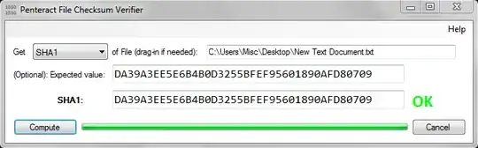

There is the FCIV utility from Microsoft, the Microsoft File Checksum Integrity Verifier (download link).
The Microsoft File Checksum Integrity Verifier tool is an unsupported command line utility that computes MD5 or SHA1 cryptographic hashes for files.
It doesn't show Windows 7 in system requirements but I've just used it in Windows 8 and it worked.
Why are we linking to a unsupported command line utility. This doesn't even intergrate into the shell which I am sure the author wanted. – Ramhound Sep 05 '12 at 12:36
31That utility was useful for me. I downloaded an iso image from msdn and needed to cheksum it. I didn't want any third party tools. I didn't need the shell integration and the author didn't ask for it. It's from a trusted source Microsoft and while unsupported it still works. I posted a link here because other people like me may find it useful. – creator Sep 06 '12 at 04:25
30I'm with @creator. It may not be supported software, but at least Microsoft is the author. Checksum programs are potentially really important to maintaining security; I'd rather not get mine from some random third-party. – ellisbben Sep 18 '12 at 18:00
3While it's an OKish utility for moderate use, it's unstable. I'm using it in a xdelta script to determine if files of same size are different and I'm sorry to say I get about 1 crash every a few hundred files. It's unreliable, so an advice: use something else. – JasonXA Mar 05 '17 at 17:58

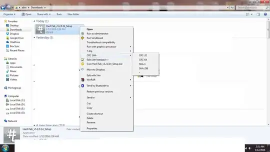

The new version of 7-Zip also gives you the option of checksums just by right clicking (this doesn't include MD5). It has SHA-1, SHA-256, CRC-32, CRC-64, etc.
For MD5 you can download HashTab and check by right clicking and then properties.

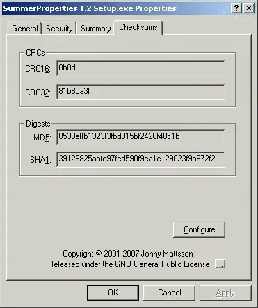

Here's one I've used before that integrates nicely with Explorer's "Properties" dialog: Summer Properties. It's open source, and an x64 version is also available.
I also like Safer Networking's FileAlyzer, which provides additional features as well. But just for checksums, Summer Properties is lightweight and does the job.

But I'll add Penteract's free File Checksum Verifier which, I think, is one of the most user-friendly programs. (Disclaimer: I'm affiliated with Penteract.)
Some of its advantages:
- Compares the calculated and expected hashes for you.
- Minimalistic - no item in files' context-menus, no extra tab on files' properties.
To verify this program's integrity (against man-in-the-middle attacks) - it downloads over a secure connection.
Plus: free, offline (so you don't have to upload your files), user-friendly (drag a file in and get the result), launches from the start menu (no need to look for the downloaded executable when you want to use it a year from now), and supports MD5, SHA1, SHA256, etc.

OpenHashTab is open source, integrates with Explorer, and is actively developed.
It's a good alternative to HashCheck, as that one isn't maintained any more (for over 6 years).

HashTab 3.0 is a free shell extension that calculates many checksums, including MD5. It's integrated as a new tab in the File Properties.
