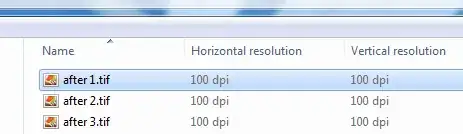

I separated the output tiff into single page tiff files to see if all pages are set to 100 DPI. As the screenshot proves, nconvert will solve your issue.
