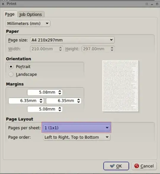

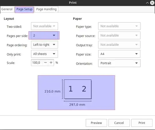

11
This is a question old enough to think that the options we have now were absent at the time, but maybe it deserves an up-to-date solution.
Linux pdf viewers usually use the printing options/properties to set the page layout, and there you can print multiple pages per sheet/side. The idea is to use those to print to file as PDF.
Evince can do it, also qpdfview. More here.
qpdfview
Evince
PDF Studio Viewer
Other pdf viewers must have similar options.
