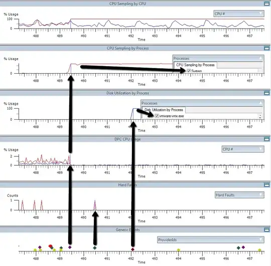

What can I see on the graph?
Zooming in on the details and getting the right tabs open results in this clear image.
What do we see?
  • CPU 1 freezes at 489,5, caused by the System process, due to an DPC caused by the purple event.
  • A hard fault caused by the green event, this can happen because CPU 2 is still working.
  • The disk is used like crazy because of the red event, looks like VMWare.
What do we see if we click further?
  • The purle event is Microsoft-Windows-WLAN-AutoConfig// launched by its service.
    As this results in a CPU freeze, your wireless drivers are most likely to be the culprit.
  • The hard fault is just the search indexer running on the CPU 2 because it thinks your PC is idle, ironic.
  • The red event is VMWare reading the VM disk, although it does this for a very long time...
    Nothing special, but as you are already running VMWare before the freeze itself occured it seems that your VMWare might have an influence on your wireless too.
What to do?
  • Try updating your wireless drivers (or disable and use a cable if it's an option).
  • Try to keep an eye on VMWare, perhaps update it to the last version or use alternative VM software.
  • Do not disable WLAN AutoConfig unless your drivers provide replacement software.
I hope you can resolve it this way, it's not the first time I see wireless drivers manage to freeze a laptop.

  • As per the link above, I've uploaded trace files (each about 60MB): [myTrace](http://dl.dropbox.com/u/21855116/myTrace.zip) and [user and kernel traces](http://dl.dropbox.com/u/21855116/myTrace_U_K.zip). The "hanging" occurred right near the end of the trace (and I could not find how to truncate the start portion so apologies for the size). If anyone is willing to take a look and shed some light on the culprit, I would be eternally grateful. – georged Mar 27 '11 at 23:29
  • @georged: Working on it... – Tamara Wijsman Mar 27 '11 at 23:45
    @georged: Done. Tell me if anything is unclear or the problem is still there, then another trace might help... – Tamara Wijsman Mar 28 '11 at 00:06
    @tom-wijsman Wow - speechless. And I always suspected video driver. I most certainly owe you one. Will update/disable wireless and report back. – georged Mar 28 '11 at 02:04
    @tom-wijsman Unreserved "thank you". Updated wireless driver to the latest and have not had a single "hang" for two days. Awesome. – georged Mar 30 '11 at 01:28
