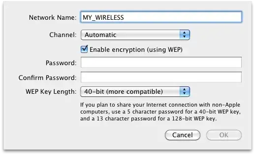

Here's a quick example. Go into System Preferences and click Sharing. Then select Internet Sharing from the list on the left. On the right side, go to "From" and select Ethernet, and under "To" select airport.
Then I recommend you click on Airport Options and set up some security for your wifi network. They only let you use WEP (bad) but better than nothing if you think other people nearby might try to latch onto your shared connection without asking. Notice the "password" should be exactly five characters and only use numbers 0-9 and/or letters A-F. Other letters and punctuation won't work. enter image description here enter image description here
