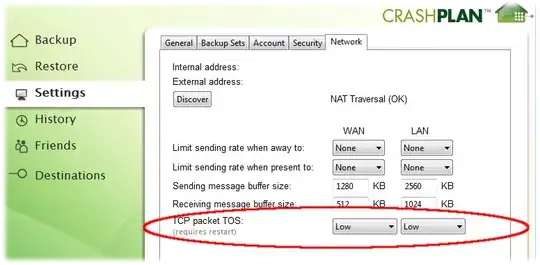

I think I have this working for DD-WRT + Crashplan.
First, test your connection with speedtest.net or similar performance tool.
  1. Configure TOS in Crashplan
    In Crashplan, go to Settings → Network → TCP packet TOS. Here I selected DSCP and input a value of 56. That corresponds to 0x38; shifting right two bits gives us 0xE, which is a DSCP codepoint we can program into IPTABLES.
    I set this value for both WAN and LAN; after saving, I did a reboot.
    To confirm this was OK, I installed Wireshark and did a trace on tcp.port == 443. After starting Crashplan I could see the output backup traffic; sure enough, expanding the IP header showed that the DS codepoint was 0xE.

There's a setting for CrashPlan to tag its packets itself: TCP packet TOS
