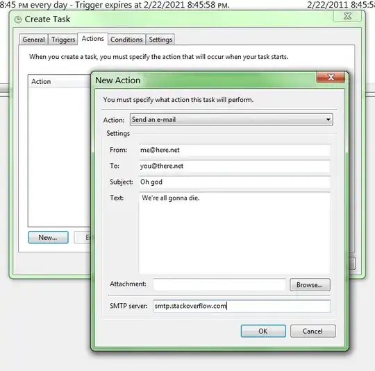

Armed with this knowledge, you can create a scheduled task that that runs when your scheduled task fails:
This scheduled task's action can then be set to something that sends you an alert - in your choice of methods (e.g. triggers a shutdown). You might just want it to send an e-mail:

  • These screenshots are from Windows 7. Windows XP doesn't support it. Windows Vista: i don't know. What version of Windows do you have? – Ian Boyd Feb 22 '11 at 23:42
  • Ian Boyd: Windows7 "home premium". Here is what i see http://i.imgur.com/Qd8QN.png –  Feb 23 '11 at 00:10
  • That screenshot is the **TaskManager**, from inside the **Task Scheduler**. Do you see **Task Scheduler** in the **Event Log**? – Ian Boyd Feb 23 '11 at 03:18
    You get the *event id* from the event log (203 and 103). You can see the event id's in the screenshot (203 and 103). Or i can tell you the event id's: 203 and 103. – Ian Boyd Feb 23 '11 at 03:20
