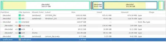

FYI. Originally, my Lenovo ThinkPad X201i laptop had Windows 7 only preinstalled. I repartitioned it in order to install Linux. This is how my disk looks like now:
Windows/Linux dual boot partitioning
  • /dev/sda1 - a small system partition that came with the laptop
  • /dev/sda2 - a Window 7 system partition
  • /dev/sda4 - a Linux partition; long time ago, it was a part of /dev/sda2
  • /dev/sda3 - a recovery partition that came with the laptop
