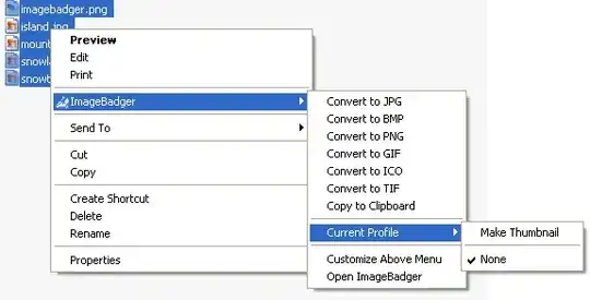

Previously called "Right Click Image Converter", ImageBadger is an image converter which has the capability to convert multiple images with right-click.
The program is a shareware. There's a try & buy version on the official site.
