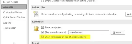

As of Version 1803 (February 2018), the "Show reminders on top of other windows" option is now available. It does not appear to be enabled by default.
THE JOATMON
  • 1,878
  • 49
  • 81
    I don't have the updated version yet, but this is great! And it's only been 7 years since I asked, too. (And that's a dis at MS, as well as a thanks to you.) – thursdaysgeek Jun 01 '18 at 18:27
    This is an excellent update to an old question. Note that this isn't quite the same as "always on top", but it does ensure the window does pop at the top of the z-order so users are less likely to miss it. – Marc LaFleur Jun 05 '18 at 16:07
  • I do not have this option in Version 1808 (build 10361.20002 Office "start in one click") from Office Professional 2019 :-( – Gabriel Devillers Jun 25 '20 at 15:29
  • I'm running Outlook for Microsoft 365 (16.0.12827.20328) and I still have the option. Weird. – THE JOATMON Jun 25 '20 at 21:53
