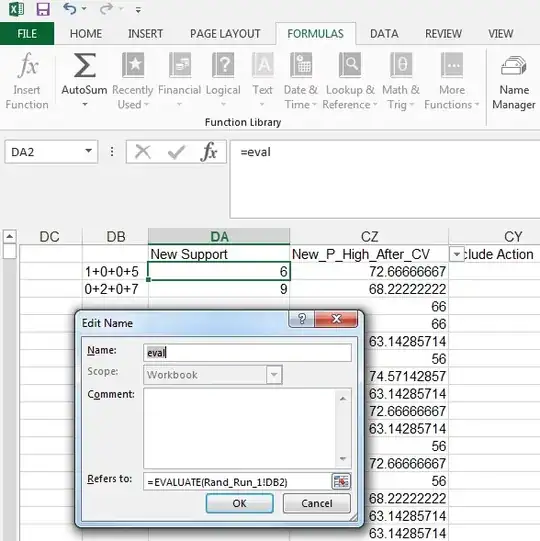

21
=evaluate(put_reference[s]_here)
This is a semifunction - it can only be used in Name Manager.
This is how you can use it:
  • Point to a cell and you open Name Manager (From the FORMULAS tab or by clicking CTRL+F3)
    Evaluate Example
  • Write =evaluate( and click on the cell you want (best to keep relative reference).
  • Finish the formula with )
  • Give it a NAME - (in this example I'll just call it eva).
  • Click OK.
Now, let's suppose that you've selected B1 and made all this refer to A1. In A1 you can put "1+1" and in B1 you write =eva - once you've hit ENTER, the B1 value will be 2. As the reference in Name Manager was relative, you can use =eva to get the evaluation of any cell one cell left from where you want it. (eg. in B2, =eva will return the result of cell A2)
    Very good - and nice to know. It even works for a table column: =EVALUATE(Tablename[@[column]]) Something you can't find in an most Excel Help- or advanced Tutorial easily – Paschi Oct 11 '17 at 20:13
    ... and as usual with excel formulas, if you use a localized build, you need to use the localized function - e.g. in Excel 2016 DE it's called `=auswerten(...)` – kiwiwings Sep 04 '18 at 13:28
14
There is an important caveat with the great answer from @karel and @Laurentiu Mirica: the evaluate function won't recalculate unless the referenced cell changes. For example, cell C1 contains the text "A1+B1" and D1 contains the function =eval. If the values in A1 or B1 change, the cell D1 does not get recalculated.
Demonstration of eval problem
This can be corrected by introducing a volatile function into either the string or the eval cell. This will force a recalculation every time the worksheet is recalculated. For example, cell C1 could be replaced with =if(today(),"A1+B1",). Or, D1 could be replaced with =if(today(),eval,). Any volatile function should do.
A third and perhaps the simplest solution is to change semi-function in the name manager to =if(today(),evaluate(c1),)

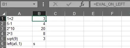

All other answers which employ EVALUATE from Excel 4.0 only show how to evaluate the text in the absolute cell reference. E.g., the formula will always evaluate the contents of cell A1 and in order to evaluate the contents of another cell one would need to create a separate named range with a different absolute path.
This will show how to employ GET.CELL to make the EVALUATE look one cell to the left.
Formulas -> Name Manager -> New...
Refers to: =EVALUATE(GET.CELL(5,OFFSET(INDIRECT("RC",FALSE),0,-1))) Edit Name dialog
Result:
This formula is better than the absolute reference alternative also because it does not have recalculation problem.
ZygD
  • 2,459
  • 43
  • Nope. Note the use of relative references in the defined named range. If you used $A$1 in the name manager it will be locked to that cell. However, if you put your cursor in B1 and define the name "OneCellLeft" as =A1 then OneCellLeft is relative and will always return the cell value to the left, relative to the cell the named range is being used in. This is a very powerful to achieve "OFFSET" like functionality without using OFFSET, which is volatile and potentially slow in large workbooks. – ExcelEverything Mar 24 '21 at 00:08
