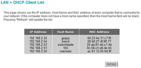

and has only issued 5 so far:
client listing
However, I am still seeing the following when I boot into the VM:

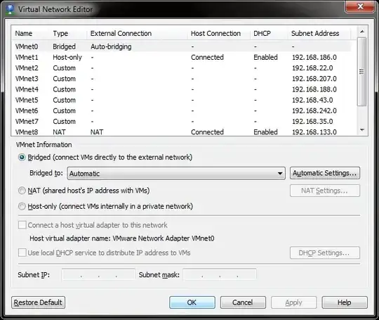

VMware's network settings:
bridging settings

Problem found, thanks to @John T's comments.
I also have VirtualBox installed, and the auto-bridging feature of VMware Workstation won't pick one of my built-in adapters because they're now labeled "VirtualBox Bridged Networking Driver Miniport" at the end instead of just the built-in names.
automatic settings
If I manually select one of the physical adapters to use for bridging, it works just fine. However, apparently because VirtualBox is doing some form of processing on the connection, it is more sluggish running bridged than NAT-ed.
I am going to remove VirtaulBox from this machine as soon as I do not need one specific VM I have running in it to accelerate VMware's network performance.
