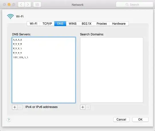

I reached to this question while I was looking for a way to get the list of DNS servers of a specific network adapter in text format (for example the Wi-Fi adapter):
This DNS servers list can be obtained in the terminal with this command:
$ networksetup -getdnsservers Wi-Fi
8.8.8.8
4.2.2.4
4.2.2.1
4.2.2.2
192.168.1.1
And for Ethernet adapter:
$ networksetup -getdnsservers Ethernet
8.8.8.8
4.2.2.4
4.2.2.1
4.2.2.2
192.168.1.1
That is the DNS server your mac is using. Your router is running a caching DNS server, and setting itself as the DNS server via DHCP. If you login to your router, you might be able to find out which DNS servers it uses.
