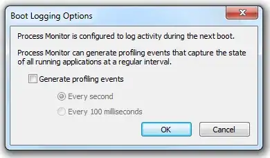

. Step 2: This will further give you this below Boot logging options. You can choose to Enable the Profiling Events, if you need.

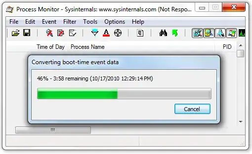

. Step 5: The file will initially be saved as a dump file in C:\Windows, you will need to convert it to Process Monitor Log (pml) log files. Save the Log file using this below dialog. This will start converting the dump file to pml file.
. enter image description here enter image description here
. Once the Log is converted, it will open in the Process Monitor tool.

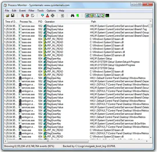

Here you can get an idea on all the applications and processes which was executed during the system boot. This report will help you identify, which process was invoked by whom and how much time did it take to for its complete execution. You can also identify if any malwares are running in your PC, which is affecting your system boot.

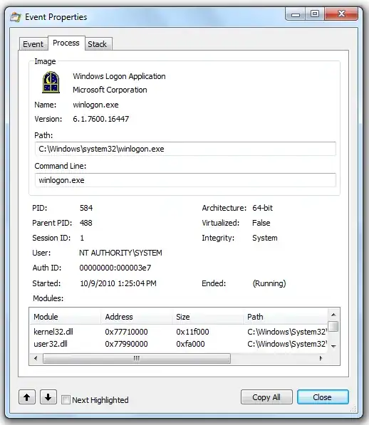

. Step 6: You can choose to filter these reports; when you click on any entry you will get the below dialog which will give you a complete snapshot on the process attributes, Who invoked it, its architecture, the Parent Process Id, along with information on when did the process transition from User mode to a Kernel mode through the Stack.
