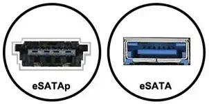

The original eSATA specification does not provide power. You'll need a USB cable or wall adapter to power the hard drive. The new eSATAp specification utilizes the USB bus to provide power over one cable, but is relatively rare.
The easiest way to be sure if you have an eSATAp device or not is to check the plug. This helpful image from Wikipedia shows the difference:

  • Thanks for your answer, though I'm not sure if I got the eSATAp or the eSATA. It's look like I got the powered one. How can I be sure of this? and eSATAp require special cable as well? – Matan Eldan Apr 05 '11 at 08:36
  • @Matan: I'm afraid that won't do. I added information about your specific requirements to my answer. – Patches Apr 05 '11 at 09:20
    Thank you very much for your help! It seems that I got this eSATAp, and that I only need this cable. I'll try that option first. Thanks again – Matan Eldan Apr 05 '11 at 09:25
