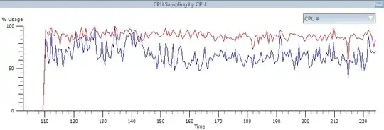

Opening the trace, the first thing I immediately see is a CPU related problem.
Even for a server, you shouldn't have your CPU at 100% all of the time...
Let's look at what processes are causing this:
What do we see:
  • Two virus scanners (avguard.exe and OnlineCmdLineScanner) that are overly aggressive.
  • Four virtual machines if I understand the VMWare architecture right.
  • Your search indexer might be inexing too much.
  • Is viewing photos and using Dropbox necessary?
  • What is Nuria.exe exactly, I think it is related to iPing/ADSLGuide, do you need this for operation?
  • There is a back-up running?
  • For the rest, there might be unnecessary things listed there, see for yourself.
Let's look at the I/O usage, which can tell us more:
What do we see:
  • Disk trashing to the page file, check your memory usage.
  • Indeed four different VMs, are you sure your server can handle this?
  • Je kijkt een film, serieus? ;)
  • It seems your are installing one or two Microsoft Offices.
  • You also have Windows Defender running, so that's three virus scanners?
Furthermore, your network driver is doing a lot, see if you can trim/filter some unnecessary network traffic.
To summarize it: You are asking too much of your machine, this easily can turn in freezes.
So, my suggestions:
  • Trim down your CPU and memory usages to something that your server supports.
  • Upgrade your server in case you really require everything you are currently doing.
  • Choose a single solid virus scanner that is meant for servers and doesn't bog the performance.
  • In essence, you should aim with the performance monitor to have at least:
    • Your CPU and memory aren't higher than 75%.
    • Your Pagefile isn't in the top 3 accessed files anymore.
  • Plan on monitoring the performance of your server regularly or through notifications to prevent this.

  • - NOD32 Online scanner is running and trigger Free AV - Defender shouldn;t be doing Virusses, only Spyware - Will check the Indexer - 4 VM's I will shut them down - Dropbox / Nuria will be shutdown - Backup can be paused - Not sure If my Son was watching a movie during Xperf I Will try to make a new Xperf with minimum loaded, Did you see the Freeze? I try to make it with a RDP session (no KBD Screen on that workstation) So perhaps when the RDp session is back, the Xperf command is Entered to late. It's increnable what you can tell from the trace :), I know i'm a little demanding from the HW. – Tukker Tom Apr 06 '11 at 06:09
  • @TukkerTom: I did not see the freeze because of the high activity, please make sure you stop the trace right after the freeze returns control to you. As you can see in the first screenshot only the last two minutes are recorded or else the log file would grow too big in size... – Tamara Wijsman Apr 06 '11 at 09:52
