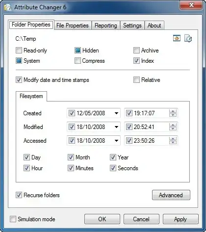

This one is freeware, and will change what you need plus various attributes that users don't normally have access to:
Attribute Changer
http://www.petges.lu/
