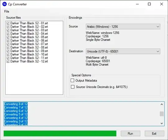

There is free and open source batch encoding converter named CP Converter.
CP Converter screenshot
Peter Mortensen
  • 12,090
  • 70
  • 90
MSS
  • 210
  • This *looked* like exactly what I was hoping for (a GUI) though no drag-and-drop (you have to use the File menu) and no ANSI option (that I could find). Nothing I did showed up later as UTF-8 in Notepad++. If this had had just a *little* more development this tool would have been nearly perfect. – John Feb 24 '21 at 11:23

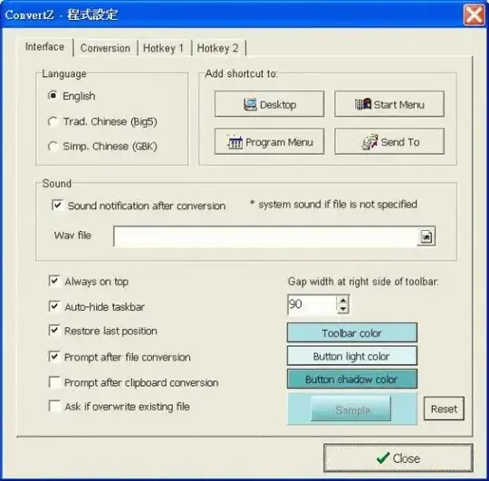

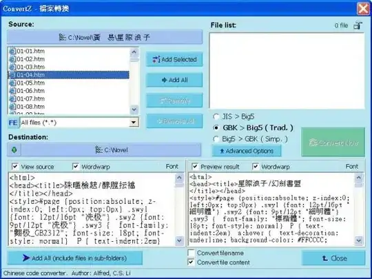

ConvertZ is another Windows GUI tool for batch conversion
  • Convert file (plain text) or clipboard content among the following encodings: big5, gbk, hz, shift-jis, jis, euc-jp, unicode big-endian, unicode little-endian, and utf-8.
  • Batch files conversion
  • Preview file content and converted result before actual conversion.
  • Auto-update the charset in <Meta> tag, if specified in html docs.
  • Auto-fix mis-mapped Big5/GBK characters after conversion.
  • Change filename's encoding among big5, gbk, shift-jis and unicode.
  • Convert MP3's ID3 or APE among big5, gbk, shift-jis, unicode and utf-8 encoding.
  • Convert Ogg tag between Traditional and Simplified Chinese in utf-8.
Alternative download link: https://www.softking.com.tw/download/1763/
ConvertZ file conversion interface
ConvertZ settings
phuclv
