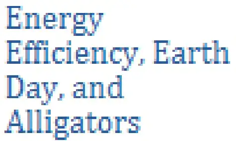

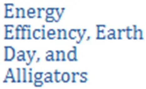

When I insert JPEG screenshots into Microsoft Word, it smoothes them instead of preserving the original pixels from the bitmap. When I then print to PDF (using Acrobat Distiller), depending on my downsample settings, I either get blurry screenshots or hugely bloated file sizes.
What I want:
I would like Word and Acrobat to leave the bitmaps alone so that they make it through the process with their pixels intact. This is what the original image looks like when you zoom in:
What I want
What I get:
This is what the Word document looks like when you insert the same image and zoom in. When this is printed to PDF, all those extra pixels result in a much larger file.
What I get
Sample files:
  • Test.png (56K) A sample screenshot image file
  • Test.docx (69K) A Word file containing nothing but this image
  • Test.PDF (9.4MB) A PDF file printed from the Word file using Distiller, with all downsampling turned off
  • Test2.PDF (98K) A PDF file generated using Word 2010's "Save as PDF" tool (note the very low quality of the compressed image)
Edit: This is with Word 2010 - I've updated the tags to reflect that.
Edit: I've confirmed that OpenOffice doesn't have this problem. I've opened Test.docx (referenced above) and exported it as a PDF from OO (choosing "lossless compression" under Images in the options), and the image comes through unharmed.
Unfortunately, OpenOffice mangles the formatting on more complex Word documents that I've created; so I can't just create the documents in Word and use OO to render the PDFs; I'd have to switch to OO altogether, which is a bigger step than I'm prepared to take right now.

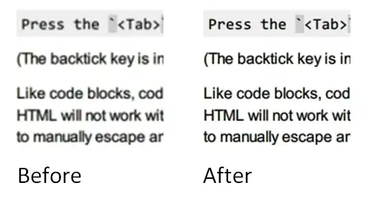

Open File > Settings > Advanced, then in Image size and quality section, check option Do not compress images in files (See screen capture to orientate where is this option located)
Word settings
The following image is the same JPG image (document capture 400% zoomed in to show anti-aliasing difference) inserted before and after activating that option:
  • Any idea where this setting can be found in Word 2007? – dimo414 May 03 '11 at 08:33
  • I actually misstated the problem in my original post - it's not that Word is compressing or anti-aliasing the image, it's that it's smoothing it rather than showing the original pixels. I've tried the setting that you point out here, but it's still smoothing the image, which results in bloated PDF output. – Herb Caudill May 04 '11 at 16:10
  • @dimo414 Click the Office button then Settings, other steps should be the same. – alexia May 04 '11 at 16:11
  • @Nyuszika7H I go to Office > Word Options > Advanced but I do not see a "Image size and quality" section, nor can I find anywhere in the settings to "not compress images in files" – dimo414 May 04 '11 at 19:36
    This is a new Word 2010 option. – harrymc May 05 '11 at 08:00
    I feel like I should clarify since this is getting so many up votes - this is a good setting to know about, but it doesn't affect the issue I'm having at all. – Herb Caudill May 11 '11 at 12:42

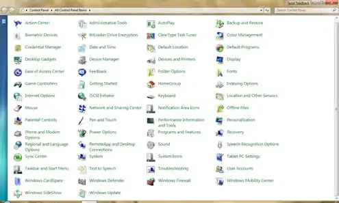

I have repeated the manipulation of inserting Test.png into a document in Word 2007, and found to my astonishment that the result depends upon the mechanism that one uses.
If one uses Insert / Picture then the picture is smoothed.
But if one enters an image-editor and does copy, then paste into Word, then the image is not smoothed.
Other possible workarounds are :
  1. Try using Paste Special as Bitmap or Device independent bitmap.
  2. Do not paste images. Use Inset tab / Illustrations group / Picture command and change the "Insert" drop-down button to "Link to file". The image file can be optimized for the Web to take less space.

    Regarding the screenshot pixelation, you can use Vista's snipping tool and save the file as a PNG which will prevent that noise. – dimo414 May 04 '11 at 19:37

Correct me if this comment is too obvious or not relevant:
When I paste a crisp Image of, say, a page of text (I tested .bmp and .png) into a Word 2010 document (.docx) the result is a blurry version of the original. This is due to automatic resizing and Image processing done by Word, seemingly regardless of the relevant settings in "Options". However if I then
  1. select the Image
  2. go to the ribbon Header "Format"
  3. select the little icon in the leftmost area of the ribbon which Looks like an Little Image with an "undo" arrow
  4. pull down the associated menu
  5. select the lower item called "Revert Image and Size" (that was a loose translation from German),
then the crisp image I pasted reappears in place of the blurred one.
Note: if I use the built-in photograph tool in Acrobat Reader, then paste directly to Word, the above does not work. I Need to take a screenshot of the whole Screen or go via IrfanView.
KUK
