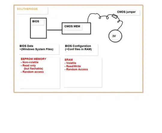

This is how it looks like in a modern computer: enter image description here
  • if the external power is cut out and you switch the CMOS memory jumper, the CMOS memory will be cut out of power (and the CMOS memory will reset its contents, as CMOS memory is a volatile memory)
  • BIOS data is in a non-volatile memory so even if external power is cut out and the CMOS battery will fail, the memory will hold BIOS data
  • although BIOS memory is read only, it can be erased (usually by using a higher than normal voltage). This happens when you upgrade your BIOS to a newer version
  • the 5V battery also powers the RTC clock
  • in a modern computer, all of the chips (excluding the battery - my mistake on the drawing) are incorporated in the southbridge
  • SRAM == Static RAM, SDRAM = Synchronous Dynamic RAM
As for the question: the CMOS battery ensures that the BIOS configuration is stored in CMOS memory.

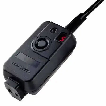

My mother uses a timer (Figure 1) to automatically turn the porch lights on and off a couple of times per day. You program it by inserting a couple of little plastic tabs that flick the switch on and off. If it is pulled out of the outlet, its clock stops ticking and it stops knowing what time it is, but the programs remain unaffected. It is the same with the timer on an oil heater (Figure 2) which uses switches/buttons instead of tabs. On the other hand, she uses a purely digital timer (Figure 3) for the indoor lights when she brings the garden in for the winter, and it loses everything when disconnected.)
Figure 1: Analog timer
Figure 2: Oil-heater timer
Figure 3: Digital timer
