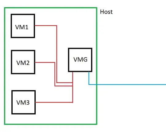

I've recently done something similar to this, using a VirtualBox Machine as a gateway, although my gateway device was running m0n0wall, which serves as an internal DHCP server and was being used as a captive portal, I reccomend you use this.
(have a look at my question to see if that helps)
On my host machine I had 4 VMS, three client and one gateway device. The gateway device was running m0n0wall, a BSD-based distro, and was configured with two network cards, one set as a bridged adaptor (and this would go to the internet) and the other would be a internal connection. The three guest clients would also be connected to the internal network, and the m0n0wall VM would be configured as the DHCP server and the gateway so all traffic was passed through the m0n0wall VM.
In my (rather poor) picture below, the green box is the host machine, the black boxes are the guest VMS, the red is the internal network connection, and the green is the bridged cable to the outside world. The monowall VM will have to do the portforwarding and may have VPN support off the bat, although I've not looked into that part. enter image description here
tombull89
  • 6,706
  • 45
  • 65
  • thanks. What configurations did you need to do to make VM and VMG acknowledge VMG as their gateway of the network? i assume you made some `ifconfig` and `route` commands but i'll appreciate if you could elaborate a little bit on this – lurscher May 13 '11 at 15:40
  • when m0n0wall was installed on the VMG there was a DHCP server activated which game the VM's (on the internal network) their IP and also set their gateway to the IP of the VMG box. There was no work done on the guest client machine. – tombull89 May 13 '11 at 17:03
