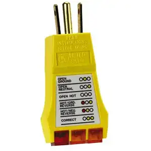

Your AC likely isn't grounded properly. You may need to get an electrician to check your wiring (or you can buy a $10 simple AC circuit tester and plug it in to see if things are wired correctly -- if ground is missing, then the three lights will indicate that immediately).

    +1 great answer. @Cédric Girard Once you get the issue of grounding resolved, I recommend running memtest x86 to test the components for failure due to static. http://www.memtest.org/ – P.Brian.Mackey Apr 22 '11 at 15:32
    In addition to the excellent suggestion to run a memory test, vacuuming out any dust can be helpful too since dust can also carry static electricity. – Randolf Richardson Apr 22 '11 at 15:49
