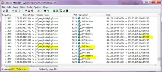

The voice traffic goes over port 19295. So i created a high priority rule for:
  • Protocol: UDP
  • Direction: out
  • Destination Port: 19295
  • Protocol: UDP
  • Direction: in
  • Source Port: 19295
Or just use Process Monitor, filter it by
  • Process Name: googlevoicechat.exe
  • Activity: Network
and watch the screenfuls of UDP voice traffic:
