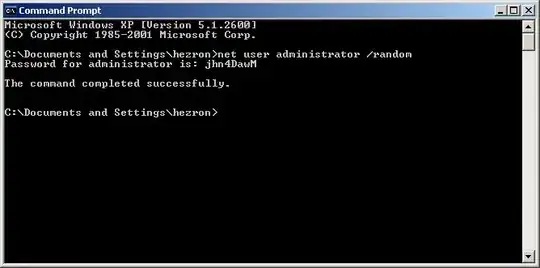

Windows-only
Warning: This will change the password for the administrator account.
Not specifically what you want, but could also come in useful. In the command line, type:
net user administrator /random
