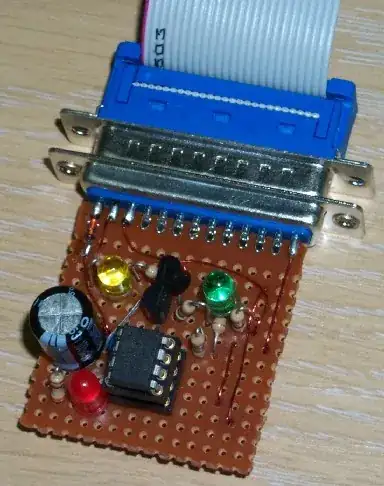

Here we have a bit-banging programmer which programs the chip in the socket. It's home-made and its main advantage is its low price, but on the other hand it needs a parallel port on the host computer to work.

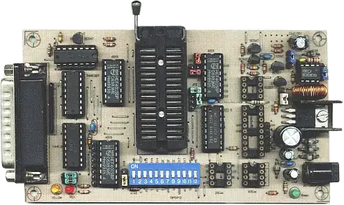

EEP-ROM programmer
Here's another programmer into which device needs to be inserted.
willem EPROM programmer
It is common to see different types of sockets on these programmers because related families of chips with similar programming interfaces are often available in several different packages.
The main difference between those two types of programmers is that the in-circuit programmers actually need a chip which is set to accept programming. Sometimes because of bad programming or by design (for example if there aren't enough pins available on the device, so no pins may be left just for programming, or the device's firmware isn't expected to be upgradeable, or because the device simply doesn't support in-circuit programming) the device is left in such state that it cannot be programmed in its own circuit. In such cases it must be removed and placed in external programmer. Usually in-circuit programmers work by connecting to the device and using a bit of firmware to download the new firmware into the device. On the other hand, the classical programmers can force writing directly to device's memory so it can be used even when it's not responsive.
So to connect this to BIOS chips. Motherboards usually have some sort of integrated in-circuit programmer which will update the BIOS chip. In case the BIOS is incorrectly written onto the BIOS chip, the programmer may become inaccessible and external programmer may be needed to flash correct BIOS onto the chip.
