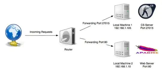

Another example would be a local network with two machines, where the second one with the IP 192.168.1.10 hosts a website using Apache. Therefore the router should forward incoming port 80 requests to this machine. Using port forwarding, both machines can run in the same network at the same time.
Port forwarding example graph
