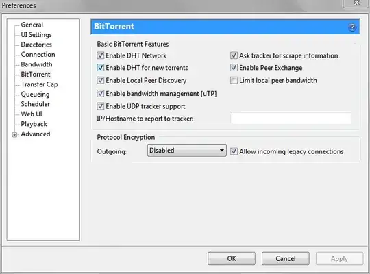

You are quiet probably experiencing a routing table overflow: It occurs when there's a lot of concurrent TCP connections, which causes the routing table in your router (duh) to take a size larger than what can be allocated in its RAM. This typically occurs with P2P usage (especially when it's BitTorrent - even more when DHT is enabled on top of that) on routers with little RAM (such as yours - cursory Googling suggests that it has a meager 8MB). In this case, additional TCP connections can't be properly established.
Possible solutions (apart from buying a new router): - Deactivate DHT in your BT client. This setting can usually be found in the BitTorrent options, here's an example from uTorrent:
BitTorrent settings in uTorrent
  • Look for a setting like "Maximum TCP connections" or "Maximum Ports" or something to that effect in your router configuration. Not every router config has such an option, but if there is, see if you can alleviate your problem by lowering its value. There might also be an option for TCP and UDP timeouts - you might also want to lower these, as inactive connections tend to linger around too long, thus clogging your routing table.
  • If that's not possible, you can also lower maximum concurrent connections in your Torrent client - in uTorrent, it's in "Bandwidth".
