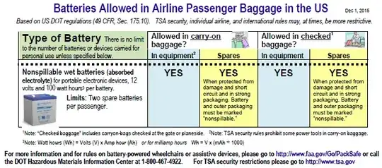

This is going to sound a little silly but it is completely allowed by FAA regulations.
You are allowed to bring in sealed Lead-Acid batteries.
enter image description here Attach a 12v cigarette adapter to that then hook that up to a small power inverter (you can get laptop ones for fairly cheep). You can then use that to charge your battery in flight.
Here is a DIY video of how to make one.
