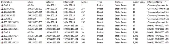

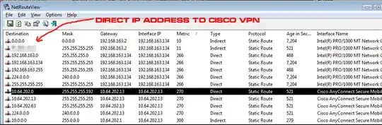

I used to think it was simply a matter of routes being added that capture LAN traffic with a higher metric, for example:
  Network
Destination      Netmask        Gateway       Interface  Metric
   10.0.0.0  255.255.0.0       10.0.0.3        10.0.0.3      20  <--Local LAN
   10.0.0.0  255.255.0.0  192.168.199.1  192.168.199.12       1  <--VPN Link

    The VPN Link has a lower metric and is thus tried before your local route. Increasing the metric of your local LAN is most likely going to disable your local LAN. If the VPN is not configured to tunnel all traffic switching your home subnet could be a solution. What are the IP's you need to access through this VPN? Is this the entire 10.0.0.0 on the VPN side? – pberlijn May 17 '11 at 15:55
  • That sounds like it very well could be the issue; i thought metric of *higher = better*. – Ian Boyd Jun 15 '11 at 02:22
    Indeed, [Lower metric = preferred](http://superuser.com/questions/198544). – Jonathon Reinhart Jan 20 '14 at 01:10

Even though my rules seems to be correct to achieve split tunneling, I still get General Failure. Did you come across similar problem as were able to solve it?
  • My gateway to the internet is 192.168.163.2
  • My gateway to the company's network is 10.64.202.1 (thus whole 10...* subnet I treat as "comapny's")
This is how my routing table looks like now (after manual modifications while VPN is on)
yet the result of ping are following
C:\Users\Mike>ping -n 1 10.64.10.11
Reply from 10.64.10.11: bytes=32 time=162ms TTL=127
C:\Users\Mike>ping -n 1 8.8.8.8
PING: transmit failed. General failure.
C:\Users\Mike>ping -n 1 192.168.163.2
General failure.
Just for the reference, below is how route table looks like when VPN is disconnected (unaltered)
and this is how the table looks like when VPN is connected (unaltered) in that case when I'm trying to ping 8.8.8.8 I simply get timeout (since company's firewall does not allow traffic to go outside the intranet)

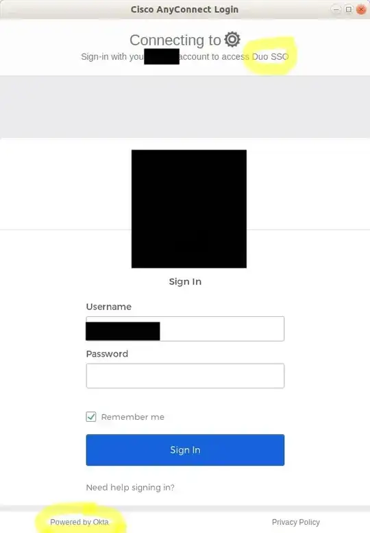

Screenshots and sequence of events during connecting:
Once I run the openconnect-sso command above, this is what happens:
  1. openconnect-sso opens up a web-page which is "Powered by Okta" (as stated at the bottom of it--see screenshot below) and which is requesting my Username and Password for Duo SSO (single sign-on) two-factor authentication. My username and password are already filled in--probably since I've done this before. It says, "We found some errors. Please review the form and make corrections." Ignore that error. I think this is just because the username and password were automatically typed in, and it doesn't detect them yet. To make it detect them, I just have to click in the username box on my already-typed-in username and press Tab twice. That interaction with the input boxes causes the form to detect that my username and password are present. It then automatically validates my username and password since they are already typed in, and then it loads a new web page. enter image description here
  2. On the new page, I make sure my correct phone number or device is selected in the "Device" box, then I click the "Send me a Push" button, and it sends a Duo two-factor authentication push request to my phone. I authenticate on my phone in the Duo app, then the webpage window automatically closes. enter image description here

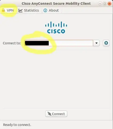

Tested with Cisco AnyConnect Secure Mobility Client version 4.10.05085 on Linux Ubuntu 18.04:

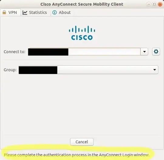

  1. Open the Cisco AnyConnect client and click the "VPN" tab. It will look like this. Your VPN server address is what is shown in the "Connect to" box. enter image description here
  2. Click the "Connect" button and it will open up a "Powered by Okta" "Duo SSO" window in a new browser window.
    1. That browser window looks like this: enter image description here
    2. The Cisco AnyConnect window now shows a "Group" box which shows your SAML Group: enter image description here
  3. Use that VPN server address and SAML Group name in the openconnect-sso command above.

Try remove those entries with gateway 10.64.202.13 see if ping 8.8.8.8 works then add them back one by one and identify which one is causing the trouble.
How did you patch the DLL. I can't even modify the routing table because it keeps adding the 0.0.0.0 with VPN gateway back.
